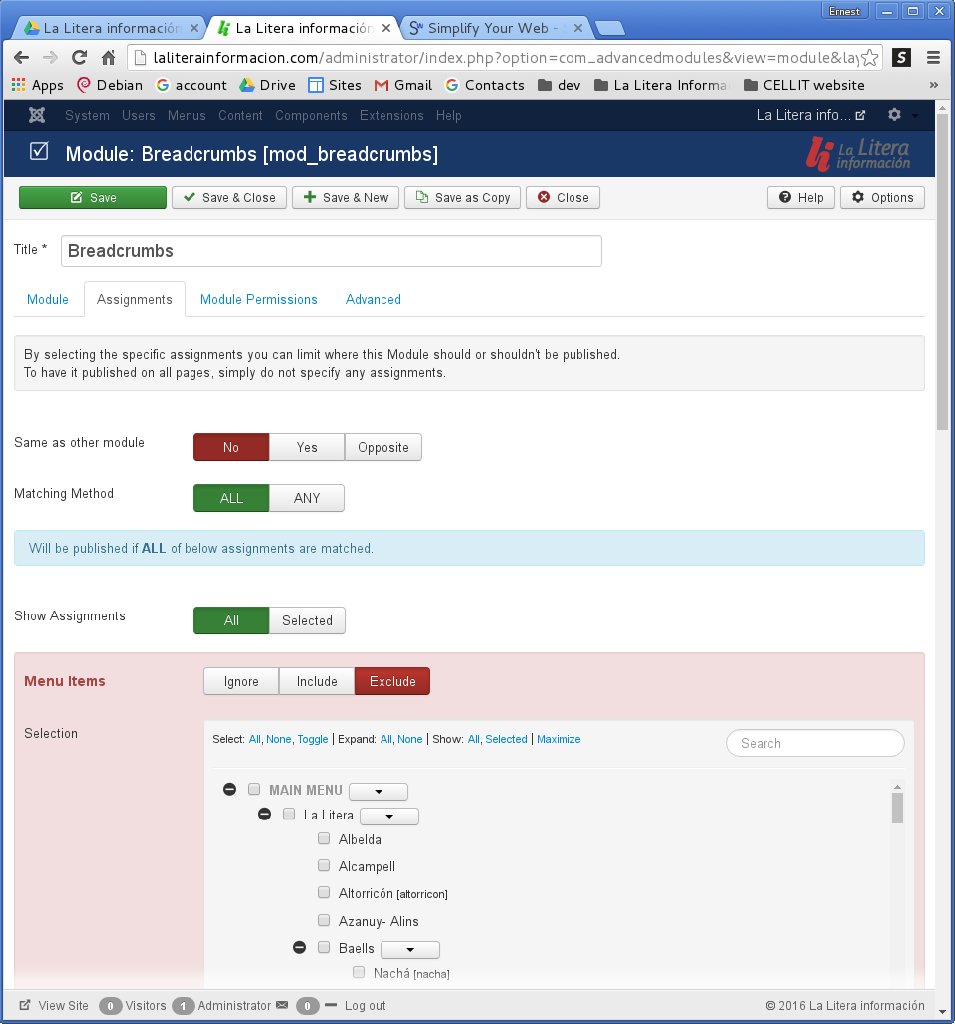

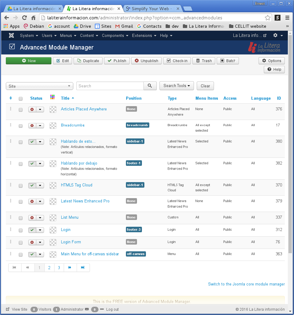

Advanced Module Manager overrides the standard modules component , presents a module manager with some niceties (attachment 1), but above all adds to every module settings an 'Assignments' tab that substitutes for the 'Menu Assignment' one and offers a fine-grained control of when and where the module will display (attachment 2).

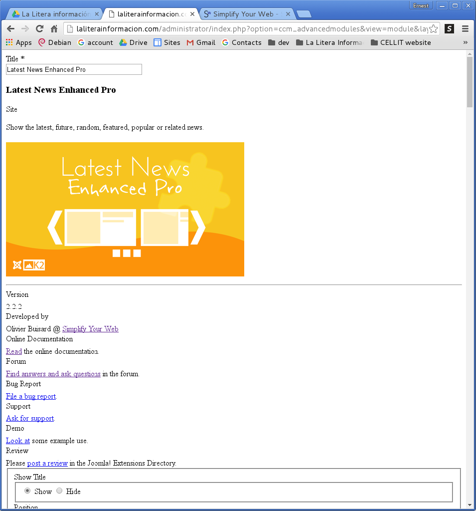

Editing LNEE modules with AMM enabled brings a dismal screen (attachment 3) that is basically the unformatted AMM 'Assignments' tab, without access to any other settings.
