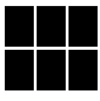

Hello, I would like to use this as a category links module in place of a category blog layout.
Is there a way to have say 10 items horizontally laid out but have them wrap so they are stacked on each other? Almost reproducing a blog layout with just intro images in columns.
My reason is the blog layouts with intro images don't have the intro images linked. My client wishes to have these linked and Joomla has no native option for this. :(
Thank you
10 years 6 months ago #4117 by admin
Replied by admin on topic Multiple Lines e.g. wrapping
Yes, it is definitely possible (if I understand correctly).
Make it look like you want in a regular browser window: let's say for the sake of an example: it looks good when each item has width of 24%, showing 4 elements per line (with margins). You don't want each item to be smaller than 150px in width, so set min-width to 150px. Now, when resizing the window, the elements will shift to the next line whenever there is not enough room for them.
