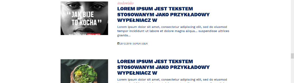

my problem is that I want to show category name in every article, but I see that when there are two articles of the same category one after another, only the first one shows the name of the category and the other one doesn't. How could I deal with this problem?

set 'consolidate' to 'no' in the 'categories' section under the 'layout' tab.
