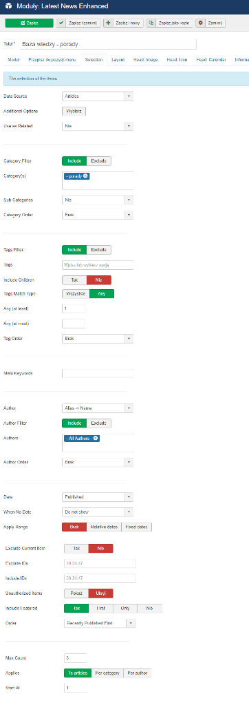

Then it is probably a mis-configuration of the module. Can you show me a screenshot of your 'selection' tab (just the category part)?

My category name is 'PORADY'
I've a few articles assigned to this category
Example:
'ARTICLE 1' have categories: PORADY, NEWS
'ARTICLE 2' have categories: NEWS, PORADY
When i display articles from category 'PORADY' via module 'Latest News Enhanced'
the module shows only ARTICLE 1 because category 'PORADY' is the first category for this article.
When articles have assigned to category 'PORADY' but is not a first category for those articles like ARTICLE 2 the module don't show articles.

Thanks for the explanations. I will double -check the database query of the module.
The scenario you stated makes sense, since the module considers that there should only be one category for one article.
I am actually surprised the Joomla core Latest News module finds your articles. Maybe my query is more 'strict' in the way categories are requested.
