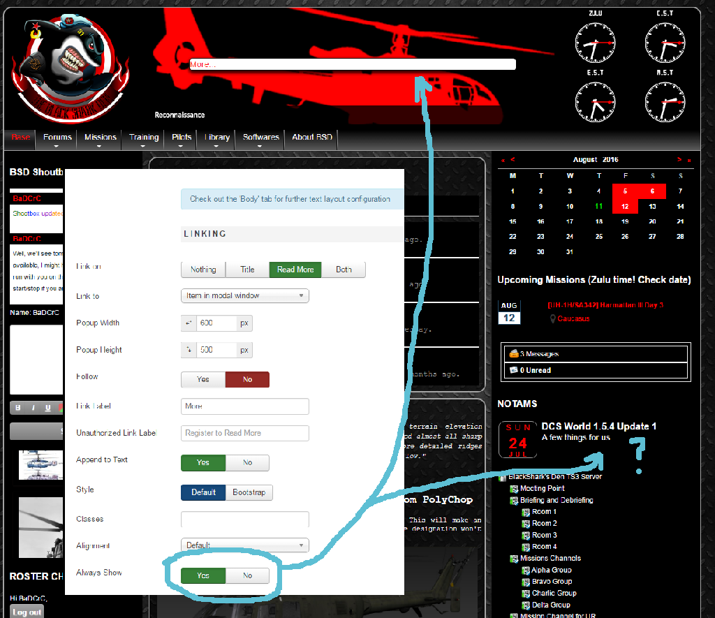

WHen I upgraded, I ended up with this:
So no link on the news anymore, and a strange in modal window floating above my banner with no possibility to close (but I could click on it to read the readmore part of my article).
So I went through the options and I found that when de activating the "always show" that was ON by default, the strange floating modal window disappeared, but still no link to my readmore section of articles:
9 years 1 month ago #4625 by syw
Replied by syw on topic Read More modal window always on...
Thank you for the explanations, I appreciate.
The module went through some changes and I would recommend, when updating from an old version and especially when updating through several major versions, to read the change logs of the module.
The module likely was in v2.2 when you installed it, went through v2.3 (major) and now v2.4 (also major).
www.simplifyyourweb.com/downloads/latest...enhanced-extended-v2.
You are definitely not getting expected behavior concerning the modal window.
It is expected NOT to see the read more link when using 'always show' to 'no'. It is because there is nothing more to show in the modal window other than what is already shown in the module.
Could you tell me if you are using overrides of the default layouts (template overrides) ?
