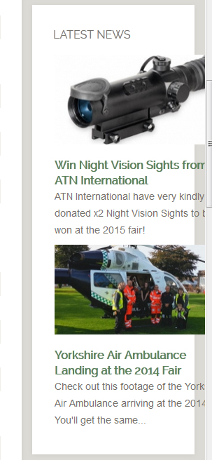

Hi there, I am using the latest news enhanced extended module and experiencing problems on smaller screens. Ipad's to be precise. The titles, images and intro text is being cut off - in other words, it is not responsive. I have set the width to 100% rather than using an px size but I still have this problem.
Attached is a screen shot of the issue when re-sizing my browser.

first of all, are you using any kind of animation? Some of the animations are not responsive.
Your text seems cut off because of the image size. Which style are you using?
The 'original' style does not resize the images (because it 'floats') therefore if the image is bigger than your smallest column size, the text will be cut off. If you are using the module in column, I would suggest using the 'fullwidth' style.
While preparing v2.0.0, I have actually found some irregularities in the CSS to ensure the styles are as responsive as possible. I am finalizing those fixes.

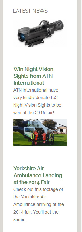

I have been playing with the styles and almost solved the issue by using the "original image (images only)" style.
As you can see from this screen shot, the images and all text are responding well. The only issue now is the spacing beneath the image. Ideally, I would like the article title and intro text to align top - beneath the relevant image. At the moment they seem to get pushed downwards to the image below. Can this be corrected with CSS?

I believe the text is not the trouble here, but the image. I am guessing that fact as I do testing of the extension on my test sites.
The image container has probably the original image size but your images are reduced to fit the module's container. Hard to know for sure on just a screenshot. But the gap is probably the result of it (image resizing but not its container).

I would suggest you try:
.newshead .picture {
    height: auto !important;
    min-height: auto !important;

Perfect! Your code works a treat
