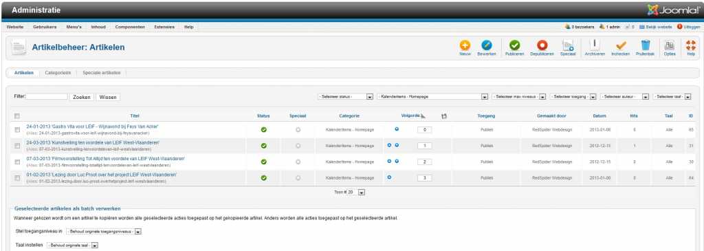

1. Homepage (article order) :
I checked the order in the article manager and the order is correct (each article has ia different order number from 0 to 3). As you can see now, all the articles have a title starting with a date. The article with the closest date to now should show first, then the article with the following date. Now you first see '24-01-2013 ...', then '24-03-2013 ...', then '07-03-2013 ...' and finally '01-02-2013 ...'. This is not the correct order as set in the article manager.

Replied by admin on topic Re: Animations
1 - can you send me a screenshot of the article manager? I cannot see what is going on.

1. I added a screenshot

Thanks for the screenshot.
Could you please click on the ordering field and save it by clicking on the save icon to see if that makes a difference?

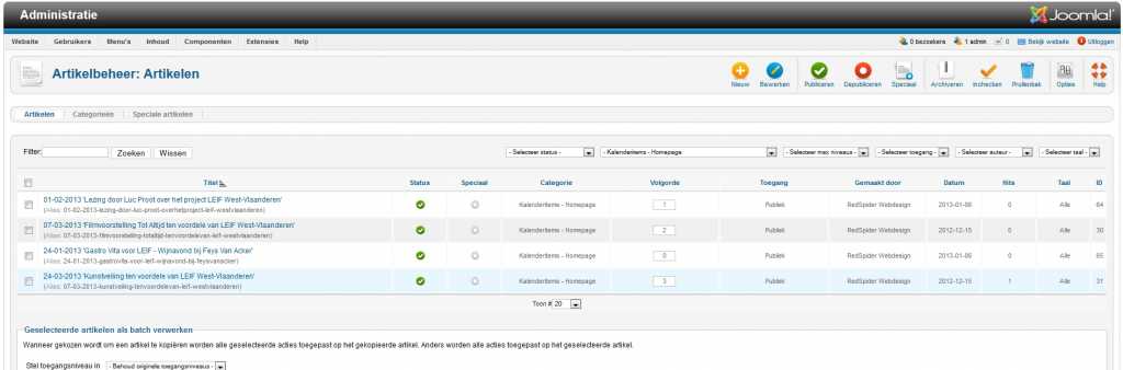

Hi Olivier,
1. I changed the article order (screenshot added) and now the articles are displayed in the correct order (-> but still not the article-manager order). I need to know that this feature works correct in all circumstances. It's not workable for my customer to 'experiment' every time they added some articles to get them displayed in the correct order.
