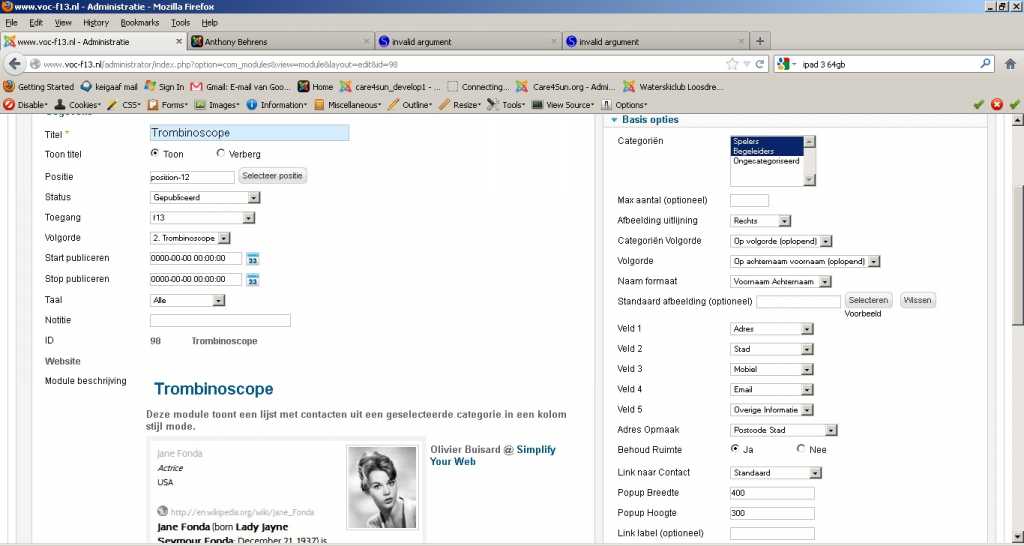

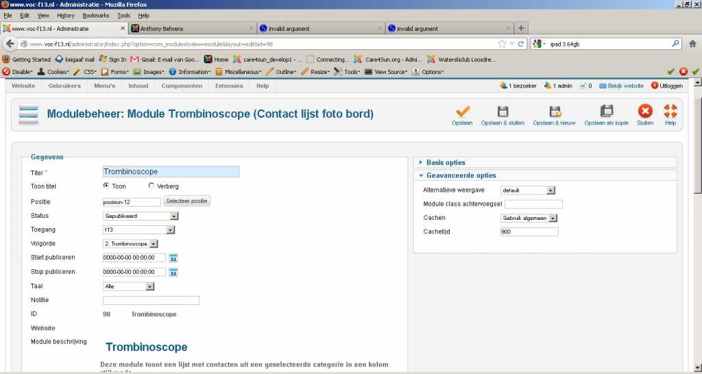

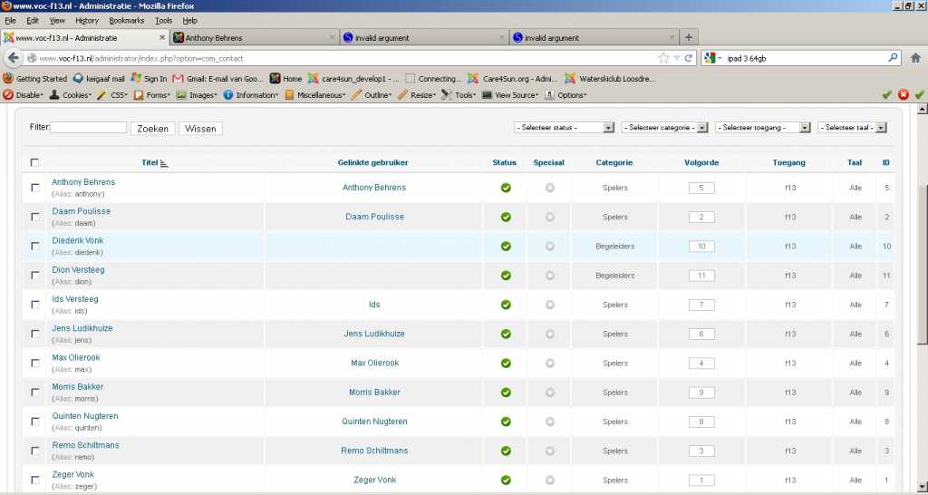

Ok, I should have known that. Here are some screenshots that may give you some clues.
I tried to override the .personpicture class by the way, but that didn't work. appearantly the pictures I used were very big although I scaled them down. I rescaled them and that seems to work fine.

Thanks for the screenshots.
Can you try with nothing in fields 1 thru 5? That would narrow things down. There is something wrong with the database query, I just cannot see what it is. By the way, what kind of database are you using with Joomla!?
