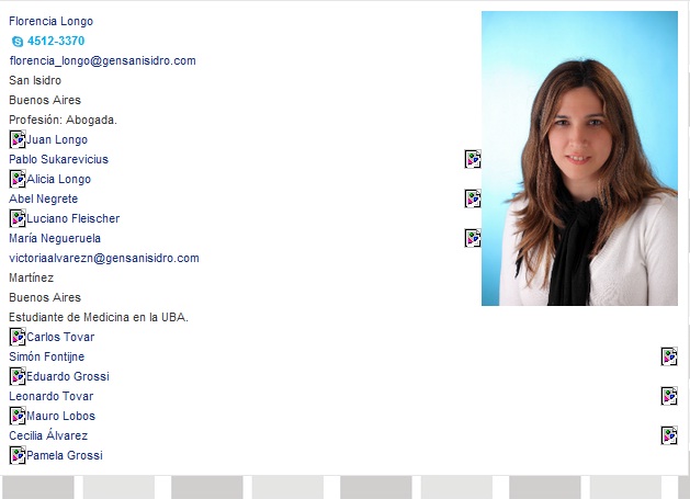

13 years 1 month ago #700 by Álvarez
Wrong display was created by Álvarez
I don't know what went wrong, I used to have the contact module but when i uploaded my webpage into another host, this is what i get. Can you help me?
If you could explain it simple to me, as i speak in spanish, i'd probably understand you better :)
Thanks!
13 years 1 month ago #703 by admin
Replied by admin on topic Re: Wrong display
Hello, can you send me the URL of your website so I can see what is going on? You probably need to set up file and/or folder permissions to the Trombinoscope module as the stylesheets are PHP files and not CSS ones. You probably lost the permissions when moving the files to a different server.

13 years 1 month ago #714 by Álvarez
Replied by Álvarez on topic Re: Wrong display
Thank you!!! I could fix it. It was indeed about the permissions. Thank you again! :cheer:
