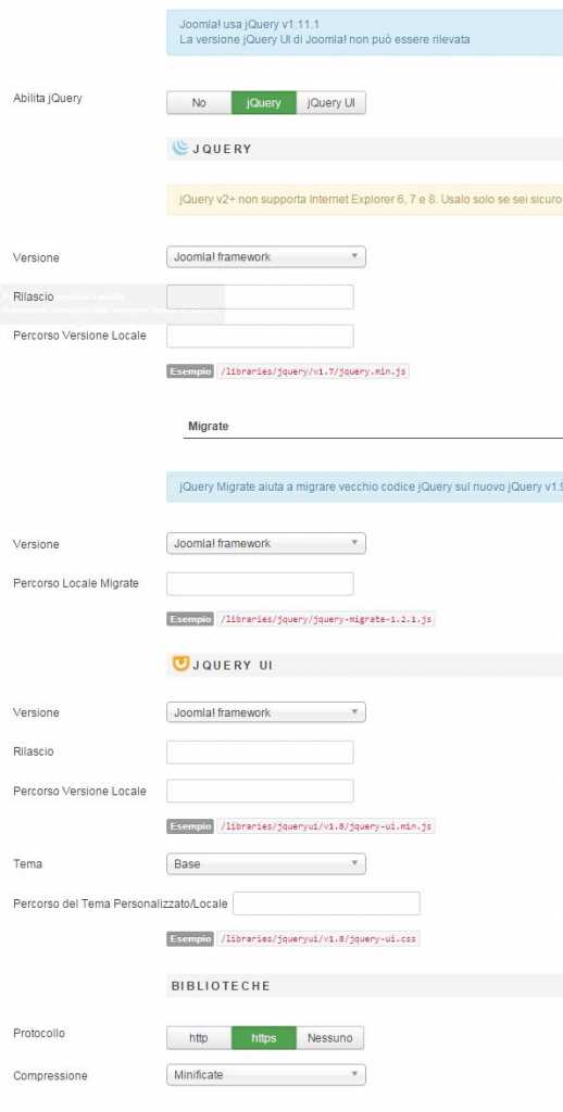

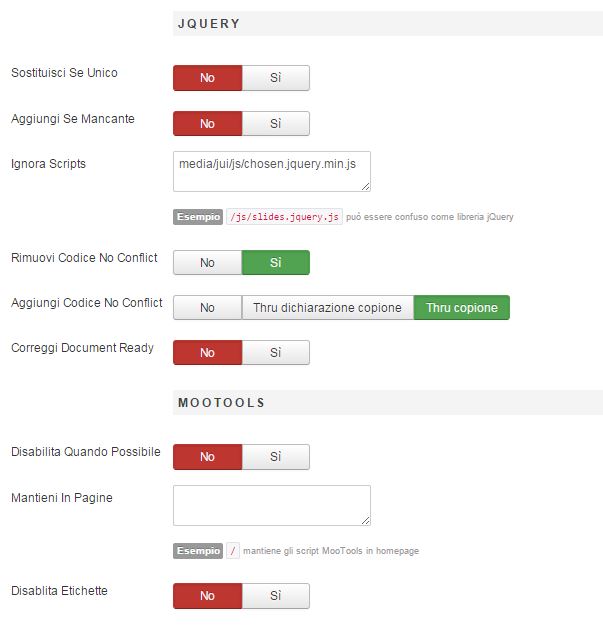

10 years 10 months ago #3835 by daddydoc
Thank you very much for answer.
I think I followed your instructions (i attached 2 screenshots) but this didn't make the trick. If you think jQuery Easy could solve my issue and you have other suggestions I'll be very grateful because i'm not a coder and i'm really stuck with it.
Thank you
David
10 years 10 months ago - 10 years 10 months ago #3836 by admin
Thank you David. The screenshots and the code prove to me that the plugin is setup correctly.
I don't think the error you are having on the slider (running on MooTools) is actually due to a conflict with jQuery.
Joomla 3 loads MooTools 1.4 and the module you use as slideshow was built for MooTools 1.1 and 1.2. I would suggest you contact the developers of the module and make sure their extension can actually work on Joomla 3.3.
