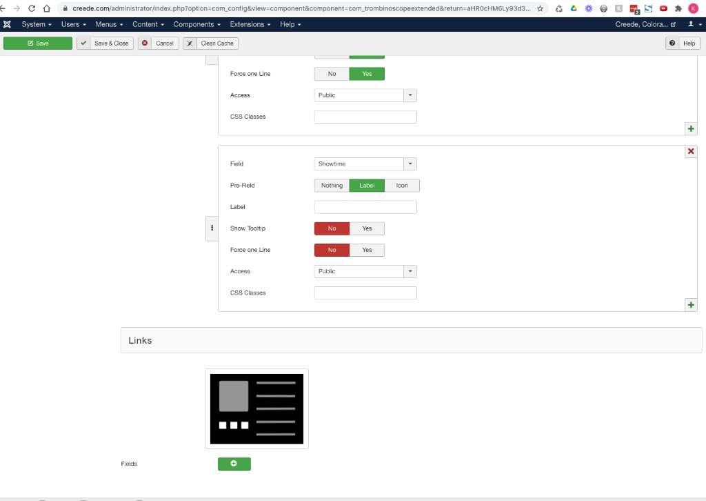

2. In Trombinoscope Contacts Pro Global Options: "Shared Options" --> In "Custom Fields" I have "Showtime Image Gallery" selected.
3. In Trombinoscope Contacts Pro Global Options: "Fields" --> In "Other Fields" I have "Showtime" selected.

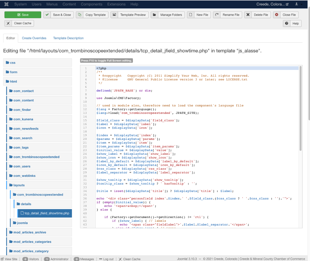

4. I have created a file (but made NO edits other than changing the file name) "/html/layouts/com_trombinoscopeextended/details/tcp_detail_jfield_showtime.php" in template "js_alasse"

Basically, you did follow the process properly. You are missing the step where you need to modify the layout itself.
However, I don't think the gallery should be shown as an additional information type for the contact. Information types are meant for info such as phone numbers, addresses... information that has limited markup. The gallery is going to have markup that may interfere with the remaining of the contact markup.
The (best) solution would be to create a custom field of type 'editor' and include the gallery custom field inside it. You can show custom fields of type 'editor' in the contact view, like you do show maps or forms.
Please check my answer to your email for all the steps necessary in doing so.
