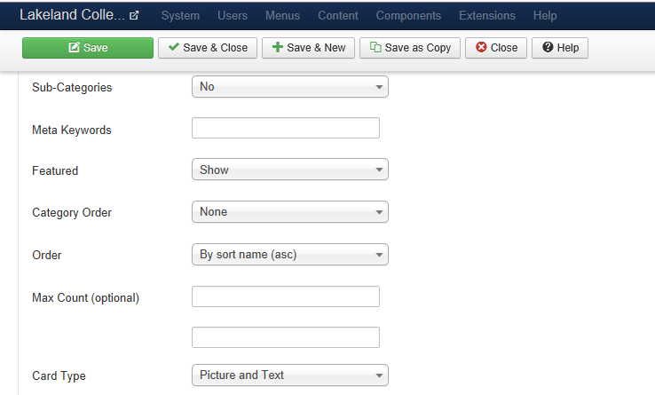

12 years 6 days ago #3124 by larosees
Replied by larosees on topic Re: Sort by last name
This is how it is sorted. Thanks!!
