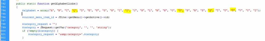

I am using the component on a website with Turkish language and want to use the "Alphabetized index" feature.
Our alphabet contains some letters (like 'Ç', 'Ü', 'Ö', 'Ş', 'İ') which are not available in the English Alphabet. There are also some letters we do not have. (like 'Q', 'W', 'X')
So I thought at the beginning it will be enough to change the code in 'function getAlphabetLinks'. But because it creates only the links, my attempt was unsuccessful.
I know, this feaute is in experimental phase. But is there a way to use umlaut letters ?
We have many person names beginning with these letters, so we can't use "Alphabetized index" feature. IT will be great to use this function in our web site.
Regards,
Bahri
(attached you can see the change and letters I have added)

But what about adding a parameter in to the interface where we can but our alphabet ? The default string value of this parameter could be the English alphabet from A to Z without any seperator. The program can loop on this string, create a link on the bottom of the page for every letter, and search the contacts table for records beginning with this letter.
It will be also flexible, so we can limit the display to specific letters. For example when I put 'ABCD' in to this parameter, the code can only filter out the records beginning with A, B, C & D.
I know, it's a lot of hard work for you to do this. But this can be a universal solution which can be used for any alphabet, with any number of letters.

I have implemented your solution (now the alphabet can be customized and can be extended, for instance one can enter 'A Ba Be C D').
Would you like to test this solution? It is part of a major update (Joomla! 3.X compatibility). Send me your email address at [email protected] and I will be happy to send you the file. What theme are you using?
