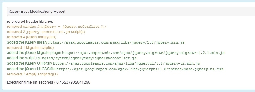

We have a site www.parrotmag.com/ that has developed an issue with the slideshows on the homepage no longer showing, the problem appearing seems to co-incide with a failed Kunena update via Watchful which has now been updated manually and is ok.
Have been using Jquery Easy as advised by CK slideshow and everything was working well until a couple of days ago. I've checked the settings but no joy identifying the issue.

what I can see first hand when I look at the screenshot you provided:
- you add Migrate, which in unnecessary when using jQuery 1.8.
- the plugin removes window.hkjQuery = jQuery.noConflict(); (the first line): either leave it as it is or re-inject that line in the expert area of the plugin or disable the removal of the noConflict code (you may want to try each option).
In the source code, I can see:
- www.parrotmag.com/media/juloalib/js/fullnoconflict.js should be removed.
This may be the origin of the issues here. It replaces jQuery with jQ, therefore the carousel can't find jQuery.
Add /media/juloalib/js/fullnoconflict.js to the list of files the plugin should remove (expert area).

the report says
added the jQuery library ajax.googleapis.com/ajax/libs/jquery/1.8/jquery.min.js
added the jQuery UI library ajax.googleapis.com/ajax/libs/jqueryui/1.9/jquery-ui.min.js
added the jQuery UI CSS file ajax.googleapis.com/ajax/libs/jqueryui/1...s/base/jquery-ui.css
