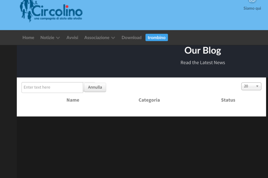

Still I have a problem wit the search tab.
I attach an image.
Is there where the option I have to hide would be stay?
5 years 1 week ago #5276 by syw
Replied by syw on topic module theme and menu item
Sorry, I misunderstood you for the menu item. I did not realize you were talking about the 'user contacts' menu item.
There is no option to remove the search field at this time (I will add it to a future release).
In the meantime, just use CSS or create a template override of the view. It is better if you use CSS (so you don't have to worry about updating the override later on):
.te_usercontacts .searchblock { display: none }
